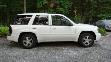

CodeWhite said:
What kind of spray can I use to get a match with the white vehicle paint on the black side skirts?
I used the duplicolor rattle cans from autozone and the color is a little off. I think it's more from the texture and inferior clearcoat than the color itself. It's still a MAJOR improvement over the stock gray plastic and I'm extremely happy with how well it has held up.
dmanns67
Apr 3, 2013
32,979
Ohio
Did you happen to sand them smooth first and also use a sandable primer prior to spraying your base coat?
AtlWrk
Dec 6, 2011
674
I did sand them but not perfectly smooth. I used the duplicolor adhesion promoter prior to the basecoats.
I did this almost 4 years ago but I don't remember it being more than 2 cans for base. I should've done more clear coat but I have had absolutely no issue whatsoever with the paint chipping or flaking.
