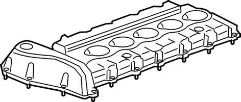

As for performing what should seem like a very straightforward Valve Cover Gasket R&R... doing so on these Atlas Engines gets to be "A LONG ROAD...WITH NO TURNS...". The process is complicated by the need to remove the Throttle Body and Intake Manifold and work around a Weird Harness Brace and PCM Wiring on the Driver's Side of the Engine Bay (and perhaps, working through the Driver's Side Wheel Well). THIS Thread itemizes the OP's 13 Hour efforts:
Some More Information:
The Oil is definitely leaking in from around the "Pear Shaped" "O" Ring Like Grommets surrounding the Spark Plug Wells... Not from the Likewise Pear-Shaped Foam Seals around the Coil Over Plug COPS. To illustrate the issues, consider that back in 1998, the GM Atlas LL8 Engine Design Team (under Mr. Ron Kociba) decided that rather than use the Old Cork or Rubber Style Valve Cover gaskets of old (265, 283, 307, 327, 350 CID Motors) they took a novel approach by "Never Allowing the Valve Cover to EVER actually Touch the Aluminum Head... NOR Allowing the Fasteners to Directly Touch the Valve Cover."
They were Clever Dudes, Yes?
They arrayed (21) of these Trapped Fasteners around the perimeter and when calculating 21 X 89 Inch Pounds of FORCE...Well ...You can get the Idea that regardless of Engine Temperature and the radical expansion and contractions that the Aluminum Head experiences over its operational life... when properly installed (and "PLUMP") this is a VERY successful method for joining the Valve Cover atop the Engine Head... and almost NEVER having the two loosen or separate their seals. :>)
They did this using a unique "O" Ring Style hemispheric outer shape nested into the Valve Cover with an "I" Beam like shape holding them buried deep into the Outer Valve Cover Inlay Slotting. And for the Fasteners...they opted to stabilize the Torque need to fix the two items together... almost floating... by spreading out a uniform mere 89 Inch Pounds of Torque around the Outer Rim and thus achieved a HUGE, Squeeze Down Force that would simply Bottom Out the Inner Steel Trapped Fasteners into the Upper Engine Head... and still allow the Valve Cover to literally "Float" upon those squished down, half-moon shaped "O" Ring Seals.
However... as mentioned by @Chickenhawk ... Excessive Engine Vibrations from Failed Gel-Filled Motor Mounts will shake the Valve Cover back and forth enough over time to gradually flatten out and wear down those rounded outer shapes and allow the Combustion Blow-By Gasses and Engine Oil Cast Off by the the Rotating Camshaft Hardware to eventually force their way inside and even fill the Spark Plug Chambers by and by with a LOT of Motor Oil and the other by-product that is always created when Burning Gasoline...Water Vapor. Thus, that Upper Primary Cadmium Plated Coil Over Plug Cover showed the evidence of the second possible source of the invading Water Vapor ...as RUST.
Here are some Images to bear out these observations:
And THESE Videos take you visually through the R&R Steps from a few different approaches, while providing More Proof of what is causing the Oil to Invade inside those Spark Plug Wells:
THIS Dude has a Great look at the differences in the "PLUMPNESS" of the Before vs. the After Views of the New vs. the Old, Sloppy, Worn Flat Gaskets once they are fully pressed into place. Be Fastidious when doing this part... You don't want to casually install any of them and it DOES take a bit of effort to do this part of this Non-Trivial Job...RIGHT:
And more information about "Blow-By":
So... Performing this involved job should NOT be attempted without considering these issues if you don't feel comfortable "Doing ALL THIS Dirty Work..."
Oh...And do the Intake Manifold Swap of the Three Figure Eight Gaskets on the Intake Manifold as well...again...Same "Trapped Fastener" Design and Caution to use ONLY 89 Inch Pounds on them.

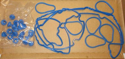

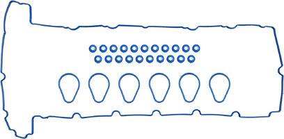

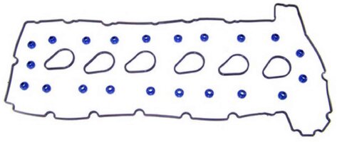

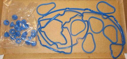

An important follow up to Post #43 and Post #47 concerns what you will GET if you have the chance to decide between ordering either the GM OEM Valve Cover Gasket Kit vs. ordering the Felpro Version. The distinctions between them are NOT trivial if you intend to be thorough in "rebuilding" the Valve Cover AFTER soaking it in a 50/50 solution of Purple Power Carbon and Oil Busting Hot Water Bath... submerged long enough to dissolve and dislodge anything that might prevent seating these gaskets correctly and avoid inadvertent Oil Leaks:
THIS is all you get when you order the ACDelco GM 4.2L Valve Cover Kit. Notice... There is NO collection of the Requisite (21) Trapped Fastener Grommets included here. There is also no explanation or description of WHY the Six Pear Shaped Isolation Gaskets for the Spark Plug Wells are BLACK... while the Valve Cover Outer Perimeter Gasket is GRAY. :

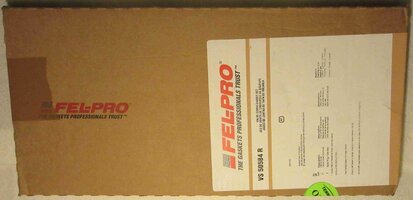

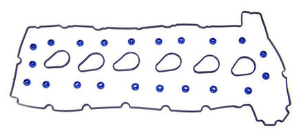

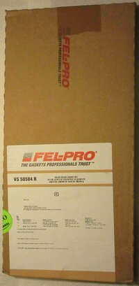

Compare THAT to this thoughtful and complete arrangement and packaging of the Felpro GM 4.2L Valve Cover Gasket linked back in Post #43 and Post #47 to the Amazon "51% OFF" Sale:
FELPROGM42LTBENVOYVALVECOVER1.jpgFELPROGM42LTBENVOYVALVECOVER2.jpgFELPROGM42LTBENVOYVALVECOVER3.jpgFELPROGM42LTBENVOYVALVECOVER4.jpgFELPROGM42LTBENVOYVALVECOVER5.jpgFELPROGM42LTBENVOYVALVECOVER6.jpg
Choose Wisely... :>)
