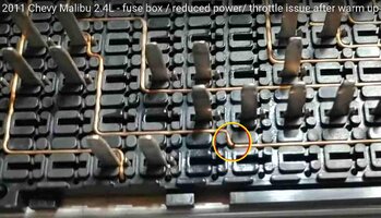

One of our Members @C-ya had discovered THIS issue and remedied what was going wrong in THIS Thread:
FUSECOPPERBREAK.jpgFUSEOPPERBREAK2.jpgTIGHTENTHESEDOWN.jpgPWRDISTCENTR.jpeg2003-trailblazer-fuse-box-diagram-11.gifunnamed.gif

Forget the evap codes for now. They would not cause driveability issues.
Follow that thread that @mrrsm posted. Then after that's fixed, it may also take care of the evap codes. If not, then troubleshoot that separately.
