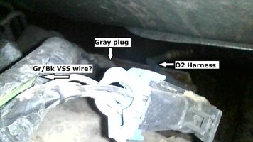

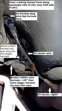

Uh-oh. This last time under the car I noticed this hanging down. Green and purple wires. I have no idea if it was like that before I had these problems or not. Anyone know where this came from/goes?
TJBaker57
Aug 16, 2015
3,028
Colorado
View attachment 114461View attachment 114462
Also looks like those are maybe twisted too much? Should have 9 twists per foot. Remember this when making repairs.
John04TB
Sep 2, 2023
27
06824
@TJBaker57 I never touched these wires so that's how they were always twisted. But thanks for the tip.

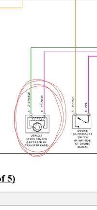

According to @Mooseman in another post (end of 2019), these are indeed the VSS wires. Now to figure out how to fix them.
"Looked up some schematics and found that the VSS is located at the rear of the TC and has LT GRN/BLK and PPL/WHT wires. "

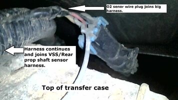

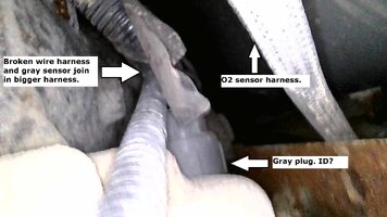

Identifying the VSS wire colors confirms that the left/11:00 sensor is the VSS. Where do these broken wires go? (I also realized those wires were dangling in the pics I took of the sensors.)
All the sensors wires go into a plastic sheath that goes above the transmission so I'm not sure how to re-attach these wires.

I wonder if the lower pic is for a 2WD TB? The upper pic looks like my 4WD. From what I've been reading there are actually 3 sensors? Are they ALL the same part?
Based on what I saw, I concluded that 4 was the VSS b/c the connector wire colors are the same as the broken wire colors, Gr/Bl, Pu/Wh. So this diagram confuses me about exactly where the VSS is. A frustration I've had since starting this fix.
Maybe a scope is the way to go. The wires seem ripped off so I need to find where they go. Or find a way to connect them somewhere else.
