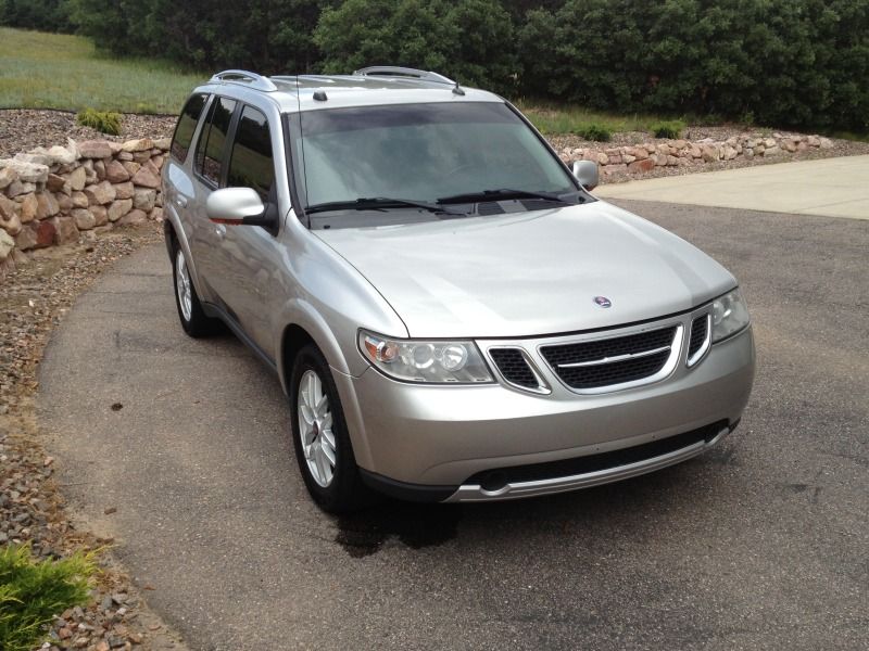

Got the front windows tinted to match the rear windows this weekend. I think it turned out great! Here are a few new pics.
Also, I know that A/C systems drip water (condensation) on the ground but this truck seems to pour water on the ground after using the A/C. I'm talking a big puddle and it typically happens within minutes of parking it. Is this normal for the GMT360? You can actually just barely see what I'm taking about in one of the pics under the right front of the truck.
GMT360s are indeed known for having overactive bladders and incontinence like that. :wink:
Seriously, I believe the HVAC designers included a higher percentage than normal of outside "make-up" air, so the condensate is always running because the system is trying to dehumidify the entire world and piss it out onto the ground. You can slow it down or reduce it by using recirculate mode, at the downside of a bit more "self-smell syndrome" in case you have an issue with flatulence. :undecided:
More seriously, some members who don't want a wet garage floor, turn off their AC a mile or two from home and let the system drain out before going in the garage. :thumbsup:
That is a really good idea. Thanks for the info.
Yeah, they make a bit of a mess. But I park on gravel outside as I have no garage, so mine can pee on the ground all it wants :tongue:
