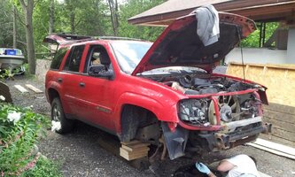

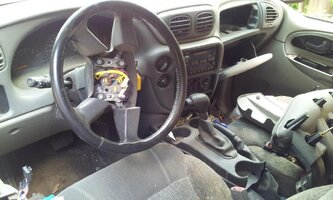

Here's a pic of the sticker to the BCM I have. Maybe a full options list can be printed by someone. Let me if the BCM will be of any use to you and I'll ship it. I have the LGM too.
Denali n DOO
May 22, 2012
5,596
Here's those pics I found.
