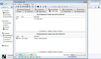

finally after 2 months the reader got the code but its a pending code not stored what that means ??

The P0301 is a problem withe cylinder #1.
As Roadie asked; Did you check the plug well for water or oil?
If the well is clear, it could be the coil, the injector or the spring from the coil to the plug.
