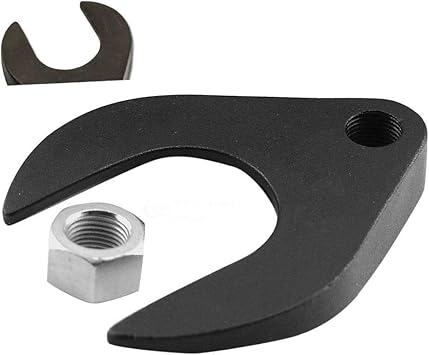

So, @Mooseman, what you're saying is that the inner splines have the notorious cir-clip set up, I knew it did already, that never releases as easy as is supposed to. The old 2 angle head pry bar tips, 180 degrees across from each other, and pop them at the same time, does not get the axle to pop out like is supposed to. I always have new cir-clips at the ready for reinstallation.
Correct. A hammer and drift or using a slide hammer with an attachment like this are necessary:
And I never heard of anyone needing to replace that circlip. It's a tough little bugger.
Reactions: movietvet
I agree that the cir-clips are tough. I had come across the need a couple times in the shops I ran though. I have had the same pair of cir-clips in my box for years though. I know of that slide hammer set up but no longer have that specific tool and attachment. When in the shops, before retirement, I had a complete set of Snap On tools mixed with Mac and Matco and Cornwell and Thorsen and SK. My retirement and move caused me to sell off some specialty tools and that set was one of them and have not re-purchased lots of those specialty tools. I believe I can rent though. Thanks.
