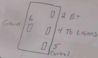

But recently the low beams turn off at random. I switch to High beams with the lever and all ok, i switch back and sometimes they come on and sometimes don't , maybe the relay?
I see the high beams relay on the cover of the fuse box but...no low beams relay?
Right... The intensity of the Headlight Beams are controlled by PWM (Pulse Width Modulation) from the PCM. Ordinarily, because of the *hectic active duty cycle* imposed, using only an ACDelco OEM Version is preferred because nothing else will last under such a high performance demand being placed upon this electronic High Frequency Switching Mechanism. The information linked in the Thread below parallels and explains this otherwise expensive purchase:
Unless this version turns out to be a *Bogus Copy-Cat Version*... You'll get better and more reliable results by spending the $31.44 Up Front and getting the OEM Version and just be done with it. Read the *Buyer Comments* to get more verification that it really solves this problem:
ACDelco 15016745 GM Original Equipment Multi-Purpose Relay
By The Way... It would NOT hurt to check out the performance of the inexpensive GM OEM Headlamp Ambient Light Level Sensor and swap in a Brand New One via this one offered by this Link at GMT Nation ...over to Amazon:
GM Genuine Parts 13498957 Automatic Headlamp Control Ambient Light Sensor
Controls the daytime running lights.
Haaa, mine is covered up with a dashboard cloth cover!! , No wonder I did not see change in the DRL's in auto or switch on.
