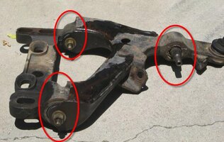

There are three bushings, and until recently, nobody in the aftermarket made replacements. GM only offered the entire assembly. And pressing out the bushings is reportedly a difficult job unless you have a respectable 10 or 20-ton press. For $150 a side, I opted for a wholesale swap, and then I got to keep my old ones for emergency trail spares.
Okay...thanks for setting me straight. Showing my ignorance. The whole assembly makes sense now. Guess you don't mind going to a Mevotech ball joint that requires greasing as opposed to the ACDelco's that are sealed. Or am I mistaken again?
