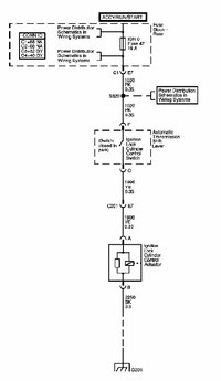

The key lock circuit is pretty trivial. It gets power from the ignition switch ACCY/RUN/START bus, through the shift lever PARK position switch then activates the key solenoid whose other end is ground.
If the ACCY/RUN/START circuit (white wire coming out of the ignition switch) is flaky, other things should also be failing, like the transmission control and the PCM. More likely it's a bad or slow key solenoid, PARK mode switch or the wiring between them all.
Does your shift lever lock solenoid work normally? The switch that detects if the shift lever is in the PARK position to release the key is in the console to the right of the shift lever. This is in the same physical assembly as the shift lever locking solenoid that clicks when you press the brake pedal, but electrically, the two functions aren't connected.

I can't reconcile these two posts. A bad battery should also fail to start the engine.
So if it is the ACCY/RUN/START circuit will just replacing the ignition switch fix it or is there something more extensive? This is why I ask...
