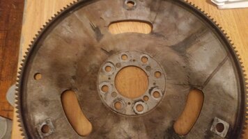

I had the same noise which came from the bell housing flexplate area...turned out that after 152K miles the flexplate bolt holes became flexplate ovals due to the power cycles.
After a long trip the noise became unbearable so i replaced both the flexplate and torque convertor.
Truck runs quiet and shifts smoother now.20230603_071204.jpg20230603_071134.jpg20230602_135946.jpg
Truck runs quiet and shifts smoother now.View attachment 108867View attachment 108866View attachment 108869

Update: Switched out the old flexplate for a new one and still has a similar noise. Perhaps it is the beginning of rod knock? Would love to find out before dropping some $$$ on another trans for it. Hopefully it is another issue but im running out of ideas. Ill try out that rod knock test.
A little history on solving the rattling noise on my Envoy.
It has been there since mid 2021 but barely noticable until i went back to old video when I had to replace a busted radiator.
The noise got progressively worse until i decided to address it by changing the flexplate bolts to ARP hoping to quiiet the issue, Did not help.
I then changed out the torque conveter since my truck transmission was slipping when transferring power in lower gears and hoped it would fix both issues. Torque conveter fixed the power transfer issue but on a long trip the flexplate rattle noise got so loud i had to go back in to replace it. I think the new torque converter accelerated the flexplate rattle.
If you have decent power through the transmission i would put it back together as is and check for other source of noises. BTW, how did the old flexplate look (any wear in the bolt holes?).
Hope this helps.

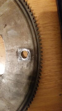

Flexplated looked fine to me, no apparent cracks or ovalized holes. Im reusing the bolts though, (put blue wax loctite on them then torqued to 18ftlbs + 50 degrees).

Well at least you elminated the flexplate as the issue,:2thumbsup:
BTW i replaced the 3 bolts (10.9 hardness) at the mounting pads to torque converter. Used blue permatex and torque to 45ft-lbs for those.
