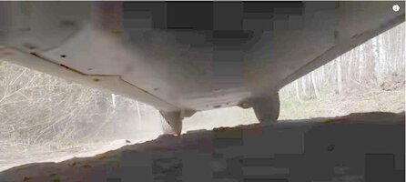

I've seen some people make efforts at improving the aerodynamics of the underside. With an EV it's easier since there is no driveshaft or exhaust. Look at what Rivian does to the underside:
We can't do it so completely, but there is room for improvement. I would start by making a cover for the area behind the rear axle.
