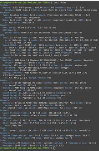

8,202
I decided against allowing the Dell Precision T7500 Server even a momentary chance to "Boot Up" with a Foreign Hard Drive inside that might bring along more problems than solutions once I got finished taking it completely apart and Vacuuming & Alcohol Swabbing and Wiping clean every single surface, fan cage and fans, MOBO and RAM Stick inside of them all.
The sheer amount of "Atmospheric Leftovers" I found inside there as *Sticky* Gamer's Dirt glommed up within this Amazing Box was staggering. I always perform this Safety Ritual on every "Questionable Box" before I ever allow them to cross my Threshold. In this manner, I've managed to avoid inheriting anyone else's "Bug Problems" by Un-Boxing these machines out in the Yard FIRST and being ready the Spray & Kill anything that might actually be hiding inside. There were "No Un-Authorized Passengers" on board THIS time. :>)
Once all of my House-Keeping efforts were finished, I was able to Fire Up and get this EXTREMELY NOISY Server to Quiet Down and Run Fast and Cool with just a bit more maintenance. I wound up replacing the Rear Case Blower Fan AND the Internal Hard Drive Cage Fan using Dell OEM Parts from a Box of Old Dell Server Projects that I've kept on hand going back to the days of the Old and STILL Reliable Dell Precision 690 Boxes. I opted to temporarily set the Sapphire Nitro Video Card aside because I want try it out inside of my other T7400 Server FIRST and then install it in the T7500 later on. The stand-in NVIDIA Corporation GF114 [GeForce GTX 560 Ti] (rev a1) Video Card will do quite nicely ...for now.
I suspect that THESE "Noisy Racket" Issues were the reasons for the "STEAL THIS SERVER" low, low price of ($365.00) via eBay. It felt GREAT to be able to do this Used Dell Server Revival and these repairs and wind up with the FASTEST, MOST POWERFUL MACHINE I'VE EVER USED! And Yet... Still the Quietest, Coolest Running One as well. It is important to mention that having taken many Dell Precision 690s and Dell Precision T7400 Boxes to their Topped Out Performance Levels over the past decade or so... THIS BOX is an Absolute *** World Beater *** by comparison.
So... Because I know that you are still working away on your Decision Process... I wanted to visit the "Terminal" Command Line Application and show what comes up after a PERFECT ridiculously rapid Installation of Linux Mint Ver. 21.1 "Vera" Operating System... and list the output data for the CPUs (lscpu) and also show you the PCI listings (lspci) from the MOBO Features to give you a Bird's Eye View of the 48 Gig of RAM (lsram) and what the Large Secondary Storage on that Enterprise Server Quality $67.00 Six TB 7,2000 RPM Hard Drive looks like after the Install. These Stats will give you an Idea of what it seems capable of doing via "Roomy Peek ...Under The Hood":
DELLT7500CPULISTING.jpgDELLT7500PCIMOBOLISTING.jpgDELLT7500HARDDRIVELSTATS.jpgDELLT7500RAMLISTING.jpg
Here's Hoping this is *Product*- ive information worth looking over as you go forward...
Here are the Geekbench Testing Results:
