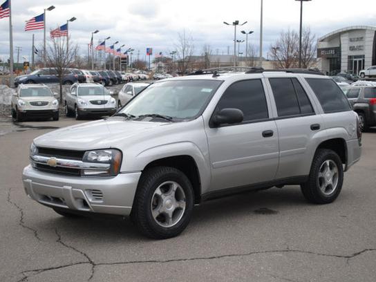

The truck was a lease car for the first part of its life, then was purchased by the lessee. It's an '07 with 88k on it. The paint is flawless. There are some stains in the carpeting in the back seat area, but the interior is otherwise in very nice condition. The engine compartment was so squeaky clean you wouldn't hesitate to eat out of it. Vehicle, over-all, looks well cared-for. It started and drove well. No untoward noises--either driving or idling and listening under the hood. The CarFax report looks good. (No accidents reported.) The dealer addressed a bunch of stuff, incl. having the gauge cluster rebuilt, already. I've emailed the salesman about the '07 driver's side switch PCB recall, to make sure they've already done that.
I tested everything except the rear window defogger (no fogging/frost with which to test it) and 4WD Low (I could not recall the procedure). Everything worked, except...
The wind-shield squirters didn't work, the radio appeared to have five bad speakers out of six (my guess is the radio has lost it--I've posted elsewhere about that), and the latch for the center console is busted. My wife noticed the Chevy badge in the center of the steering wheel was dented-up a bit, so they've going to check to make certain there's still an honest-to-God functional airbag in there.

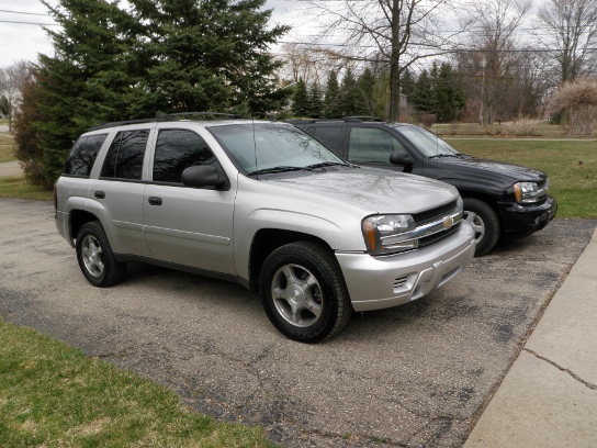

SEMIJim said:Well, we're now a Two-TrailBlazer family
Report from our mechanic: "Looks really clean. You don't often seem them that clean. It's tight." "We did well," I asked? "You did very well," he replied.
He cited two issues he felt should be addressed under the dealership's 3-month/3000-mile power train warranty: The transmission coupling hoses are badly rusted and should be replaced (he says this is a common problem with TrailBlazers and some other GM vehicles--I think we paid him to replace them on my wife's TrailBlazer) and the front pinion seal is leaking.
