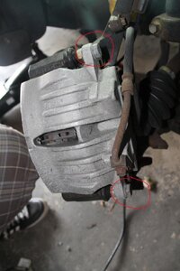

4) Remove the two 17mm caliper bolts and hang caliper so it's not hanging by it's brake hose. Set brake slides and pads aside.
5) Remove the two 18mm caliper bracket bolts and set aside caliper bracket.
6) Set the brake rotor aside.

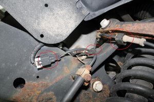

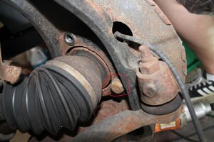

7) Completely remove the 5 plastic clips that hold the ABS sensor cable and unplug it, unless your new hub didn't come with the clips. Let it hang to the ground.
8) Remove the two 10mm bolts that hold the brake hose to the knuckle.

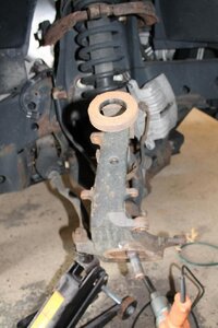

9) Remove the three 18mm wheel hub bolts. You may have to turn the steering wheel from side to side to get at the bolts.

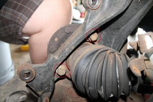

10) My hub came out pretty easy after a hit with a hammer. Most hubs I come across aren't that easy, yours may not be so easy.
11) This maybe isn't necessary, but I used a puller to get the hub off the axle shaft. It was available so I used it, and it came off super easy. You might be able to tap the axle shaft out with a hammer.
12) Once the axle shaft is out of the hub, remove the hub and dust shield from the knuckle. Also, clean the surfaces of the knuckle and dust shield of any rust or debris.

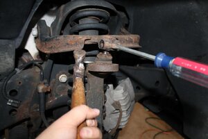

14) I wedged a screw driver to loosen up the upper control arms grip on the upper ball joint. Then, I was able to lightly tap up on the control arm to get it off the ball joint.
15) Remove the snap ring from the ball joint. I was able to tap it off with a screw driver and hammer.
16) Here is the setup I used to remove the old ball joint. I didn't use the pieces as they were intended, since I don't think that the correct pieces came in the ball joint kit. The old ball joint came out with ease regardless. You'll have to be creative.
17) This is the setup I used to install the new ball joint. The kit does have the correct pieces for the install unlike the removal.

23) Route the ABS sensor wire and clip it back into place. There are a total of 5 clips. Plug the connector back in to the harness.

I think the problem is that you have the wrong ball joint set. The setup I used is pictured exactly. The top of the ball joint stud actually went up into the hollow part of the threaded rod. If you have advance auto parts nearby, rent their 23 piece ball joint set. It has all the pieces.

A little shortcut:
No need to remove hub assembly. Axle nut removed, swing steering knuckle out and tap the cv shaft in with a hammer at the same time.:thumbsup:
Normally, no unless you replace some other parts like tie rods or lower A-arms. It's not a bad idea to do it regardless just to be sure everything else is good.
