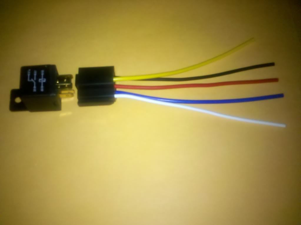

I have relays with the 5 wire plug for $6 plus shipping if anyone ever needs one
