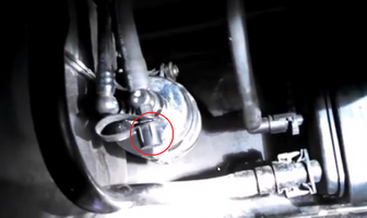

No. It's under the truck near the fuel filter.

Using this inexpensive FPG Kit from Harbor Freight will help and won't void your existing extended service warranty...
...after pulling this protective Black Plastic Cap, cover the Schrader Valve with a cloth and bleed off the internal pressure by depressing it first (...be careful not to get any gasoline sprayed into your face and eyes here). Then hand snug the correct hose-adapter with the gauge and start the engine to capture the dynamic fuel pump pressure. It should be viewable with the gauge propped up on something just aft of and underneath the driver's side door frame rail:
