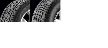

The tire on the left is what I had, upsized to a 265/60/17 over my stock size 245/65/17 in a Latitude on the right. I lost 40-50 miles per tank and that's 2-3 MPG drop and was closer to 3. The tread is not aggressive but just the design of the tire. Just something to reference as tires definately play a role in MPG.
I was getting 220-230 per tank over 270-280.....huge difference which is why I sold them, handled real well though. :biggrin:

Here's another look, I believe the tire on the far left is the OP's tire. Note the more aggressive pattern but not overly.
Ok, point well taken. So you are saying it could be a combination of things including winter gas and tires? Ok sounds logical...however the same rolling resistance is encountered in the city and on the highway. So theoretiocally we should see a proportional drop in city as well as highway mpg. If we went by the logic you are proposing we should see both poor city and poor highway mpg. Which he doesn't
