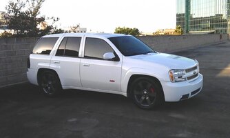

Here is my truck, 30.75 front 31.5 rear ground to fender. tony's a-arms and a combination of the belltech drop struts and ground force coils (front) and belltech rear coils and shocks.
I'll take some better pics at a later date.

Sooooo unfair you can be that low and never have to worry about snow! :raspberry:
