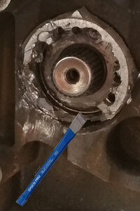

Well after tackling it this morning, I was able to get the needle bearing out like the post shows. But, I think mine is more corroded than what the authors has. I chiseled, as much as I could without too much damage. I even tried to grind it out with a dremel tool that has sander attachments. No luck there. This is going to be my next option. I am going to replace the drill bits with a dull blank. Then set the depth on each cut lower and lower until I make it thin enough to pry out the rest of the way. All I could find in a carbide hole saw was this harbor freight kit. 2 1/2 is pushing the safety limit I am comfortable with. I would prefer a 2 1/4 diamond or carbide instead. If this does now work I am at a loss as to what to do. The car has 250,000 miles and is in pristine condition. Any thoughts? I think I am very close to a solution. What would it take to have a garage tow it in and fix it. If I admit defeat.

Well after tackling it this morning, I was able to get the needle bearing out like the post shows........
Trails1960, you are almost finished. Take a 1/2 or 3/4 inch cold chisel and place it on the area shown in the picture below (the yellow rectangle) and pound directly into the depth of the bore (parallel to the intermediate shaft, that is the axial direction). The aluminum of the disconnect assembly is soft and brittle. The cold chisel will fracture the casting, break it's circumference and free it up. Remember you pound on the broken edge into the depth of the bore and not against the bore. There is some air space between the oil pan bore bottom and the nose of the disconnect assembly, so you will not be pounding against a solid bottom. The fracture pieces will also push the seal into the bore. It is okay, there is plenty of extra depth in that oil pan bore. The cold chisel is not cutting the metal it is being used as a punch. Good luck and let us know how it turns out.

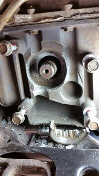

Midland
Do you mean position the chisel like this and beat toward the rubber seal in the bottom of the bowl? Would you think trying that carbide drill would be dangerous?
The shaft to the hole saw is 3/8" I was going to grind down the shaft to make it blunt then slowly using the 2 1/2" carbide bit drill the aluminum. Once I get about 1/8" into the casing. I would readjust the pilot bit and then drill a little deeper. Mine is really really fused in there. Using the pilot bit pressed against the shaft. Please advise.
The picture is done is ps. It is really tight in there to get a hammer to even strike a blow isn't it. :smile:

Mar 5, 2016
13
Midland
Had an after thought. What about an air hammer with a modified chisel on it? I am finding it more and more difficult to get a hammer in there to strike the chisel.
Just an afterthought. HF has em for 13 bucks at 90 psi.
Use a square end chisel and not an angled chisel that you have shown. Rotate the chisel 90 degrees from what you show in your picture. You are placing the chisel end bluntly on the top of the fractured exposed land.
The space is tight for a hammer swing. If need be, make a makeshift extension for your chisel from pipe or socket and extension (which might get ruined) so you can get a good hammer strike. Use a 2 lb mason hammer especially when using extensions so you don't dilute the momentum of the hammer blows to the casting.
Study pic 22 in the article and look at the 2 chips labeled "axial". That is what you are trying to achieve. Angle your chisel slightly towards the bore wall (like you would to score or damage it) so that you do not chip off the edge of the land and destroy your working surface. You want to keep the nice square edge top land so you have something to pound on. You are trying to punch in the cylindrical wall, (the long way) of the disconnect assembly nose, into the bore of the oil pan. It sounds counter-intuitive but the aluminum casting is brittle and relatively weak. A few good blows will cave it in.
Remember you are striking in the axial direction. Make sure you understand what this means as I think you are confused on this term. Imagine a bicycle wheel. The spokes are in the radial direction. The axle is in the axial direction. Axial is perpendicular to radial. On your truck, the intermediate shaft is the axle. Position your chisel end on top of the land with the body of the chisel in the axial direction (ie. parallel to the the intermediate shaft).
The carbide hole saw is definitely not the way to go. You are not trying to drill out the disconnect assembly nose from the oil pan. You are just going to punch in a small portion of the nose to break its circumference. Once you do that the rest of the nose will loosen up.
If you cannot pound in the land, try adding two holes in the location shown to further weaken the nose and then try again with the chisel located between the holes. You can tweek by enlarging those holes. The side wall will break at some point.
Don't get discouraged, you have done well up to now and just a few minutes away from successful completion.
I see now you mean a wood chisel. I have some I can use and resharpen if I have too. do you mean drill out where I put the green circles?
Yes, drill two holes where you have the green dots. Use an 3/32 inch drill or smaller to start, and then enlarge them to as large as possible without damaging the oil pan bore. Drill all the way thru the casting nose (about 1 inch deep), you will feel it when you break thru the other side.
No, do not use a wood chisel. Use a metal chisel like the one you had in your last picture but with a square end instead of the angled end.
After you drill the holes, use your chisel like a punch and push the area between the two holes into the depth of the bore. The casting will break in the thin area around the two holes. To clarify, you are pounding the material in the axial direction.

Ok got it out after about 4 hours of chiseling. Now this happened and I don't know if I screw something up or not. I got it down to the seal, it was mentioned to remove the seal with some screws drilled into it.
This came out pretty easy, BUT the shaft also came out about an inch with the seals. I immediately pushed it back in hoping I didn't mess some alignment on the drivers side.
I will post a bunch of pictures for you to see what I am talking about. I called my local mechanic shops around here and most of them told me I'm on my own and they won't offer any advice.
I looked at my before and after pictures and I don't really see any major protrusions that would make too much of a difference. In one of the pictures you can see that I lined up the bolt hole pattern to make sure I had the right part.
The disconnect is not going on like the videos show. Do I have to tap it? Did I mess something up on the drivers side. The shaft will come out easily about an inch to let it be rotated. Is the shaft broken? Should the shaft be solid and not move at all? Maybe the pictures will explain. I am stuck as to what to do now after feeling like a champ beating up this ring.

... the shaft also came out about an inch with the seals. I immediately pushed it back in hoping I didn't mess some alignment on the drivers side...................
........ The disconnect is not going on like the videos show. Do I have to tap it? Did I mess something up on the drivers side. The shaft will come out easily about an inch to let it be rotated. Is the shaft broken? Should the shaft be solid and not move at all? Maybe the pictures will explain. I am stuck as to what to do now after feeling like a champ beating up this ring.
The intermediate shaft is held in the differential with a retaining ring similar to the CV shaft. Push the shaft into the differential so the splines line up, then knock it in to overcome the retaining ring.

Kind of figured it out. I think they sent me the wrong disconnect. Reason I say this is because I fitted it on the cv axle shaft (wheel side) and it fit fine. I put the old gears on the shaft and they slip right in. On the part I bought if you look at this picture this is the exact room behind the bolts that shows inside of the shaft. It is not the shaft that is the problem it is the needle bearings or gear size that won't let it come the distance. I contacted the company by phone and will hope to resolve this soon.
I measured the distance to the center of that bearing and it is the same distance from the bolt to the body of the disconnect from behind.

2003 Trailblazer ext 4 wd LT. engine is a 6 cylinder 4.2. Going to call powertrain tomorrow and see what my options are. Did a bunch of reading on this and not one had an issue with it lining up and fitting the intermediate shaft. Now some did say that the shaft can go bad if it is dry and mine is dry. I don't even know where to put in the liquid. The only reason this whole thing started was because the cv axle was rolling around inside of the disconnect and the needle bearings where completely gone. Anything this old something is bound to give eventually. 250k and counting.

There is a seal on the nose of the disconnect housing that the intermediate shaft has to slip into. Maybe there is resistance there and you are not pushing hard enough to overcome the seal slipping over the intermediate shaft. You have to apply some grease to the seal to aid the slip on.
Did you remove the old seal?
It would be helpful to see some pictures of the oil pan bore, and a measurement of the intermediate shaft projection from the bottom of the oil pan bore.
trail1960
Mar 5, 2016
13
Midland
Removed the old seal, as it shows in one of the pictures. The old gear fits on the shaft I took out. I spoke with powertrain and they going to send out a replacement. Their concern was the intermediate shaft being dinged up or scored. I can send the old one back once it I get the new one on. When I went to clean up the grease and the anti seize I put on there, I did notice that at the beginning of the gear where the shaft is to go on was chamfered some. The old gear was not. Maybe its a bad gear inside of the new one?
I do not think you have a wrong or bad replacement part.
Looking at this picture, The exposed splines are correct. The splined area of the disconnect assembly is composed of two splined hubs adjacent to each other that grip the intermediate shaft and CV shaft. I cannot see the parting line in the picture so I assume that the intermediate shaft end (shown) is fully and slightly over inserted, so the parting line is not visible. That leads me to conclude that the intermediate shaft is not fully seated into the differential assembly.
If you can pull out the intermediate shaft with just your fingers, then it is not seated.

Success. You may not believe this or not. But the pictures will dictate what is working. I called up powertrain and spoke with their ebay guy. I asked him if the intermediate shaft was connected somehow on the drivers side. He looked it up and said it is not. No alignment ring or retainer ring on my model. It is a 32 spline he said on both sides. So I figured it can't hurt to pull out the shaft and insert into the part on my work table. It slide in like butter. I then went one step further and tried to fit the entire unit back in with the shaft still inside the passenger side. The same distance and stuck thing happened just like before. I thought why not try it without the shaft and see what happens. Well this did the trick for me, taking some calipers inside and outside I measure the hub on the engine and the part on the table. There was a 1mm difference. Taking a harbor freight wire disc I cleaned out the inside while blocking the part off with a rag where the intermediate shaft went. Did this a couple of times and it was slowly getting in there. I then took some 80 grit belt sander paper and sanded down a ridge on the back of my unit. Taking off a 1mm thickness did it for me. After gooping a ton of anti seize on the part, I put it all back together and it slide in like butter or a greased monkey. It is now assembled and waiting for me to torque the nuts and bolts except for the brake pads. I learned that aluminum will shrink under high heat. The aluminum to aluminum was a bad idea to begin with. That corrosion will stick at the molecular level to itself. I hope if anyone else reads this it might help them with their part as well. Mine is about to get back on the road. Thank you again for taking your time and posting on this forum your setbacks and victories on your disconnect and thank you for
saving me a ton of money.

After reading this thread I decided to try removing the seized end of the bearing housing using the methods described above. I drilled two holes across from each other. Instead of using the 9/32 drill bit like Camdo did, I decided to live on the edge and gamble by going with a 5/16. The reason I went with a 5/16 is so I could tap the drilled hole with a 3/8 tap.
After drilling and tapping the two holes I threaded a 3/8-16 X 3" full thread bolt in each hole. I drilled and tapped the holes all the way so I could try using the bolts to jack the broken piece out. I put a washer on each bolt so I could have something more to grab with the slide hammer.
I tightened the bolts as much as I dared. I couldn't tell if the broken piece was moving or if I was stripping the threads in the broken piece so I stopped tightening and gave about 10 good hits with the slide hammer on each bolt. When I started to tighten the bolts again I could tell that something let loose.
I cranked the broken piece out with the bolts and got the rest out with a slide hammer and hook. Thanks for the advice, it gave me the courage to get out the drill and get the piece out.
The oil pan looks pretty good. The bolts left some small marks where they bottomed out but shouldn't hurt anything. GM sure made one robust oil pan on these rigs.
