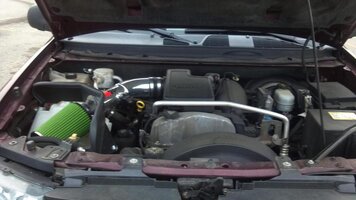

Ok, 2048 fits.. But there are some minor issues.
The lip is smaller than the k&n which normally wouldn't be a big deal
The metal hai has a slight taper so the filter wants to pop off the end of you can't slide it past the taper. The washer reservoir stops you from moving it high enough.
The rings on the pipe are where the k&n clamp goes. Now, this isn't really a big deal at all, you just have to lift the pipe about 3/4" and push the filter up higher. I also loosened the clamp at the intake to let the pipe adjust a bit. I don't think there is enough pressure from the reservoir to deform the filter or create a leak, or rub a hole in either one.
Really this is just a long way off saying it fit fine and looks good.

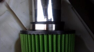

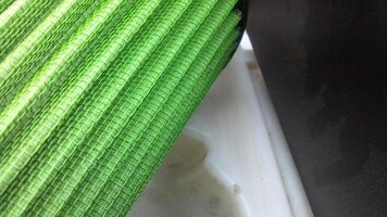

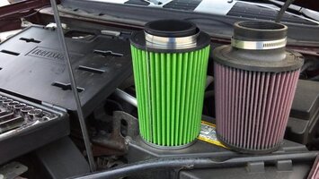

Is the end cap of the filter solid stainless steel or is it open on the end with filter material? Looks like you will have more filter media to draw air through. I will be investing soon. Thanks for the feed back sir :thumbsup:
the end is stainless, looks pretty good actually
