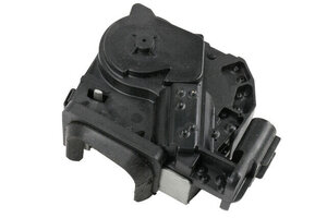

i have a 2004 gmc envoy xuv the rear door wont swing out or lay down any body have a clue whats wrong or how too fix it
The manual release to at least make it swing is behind the tailgate if you're inside it it is on your right hand side it is basically the electronic lock if you look very closely you will see a shiny silver metal tab it's small if you push it all the way to the top it will open I was pulling my hair out trying to figure this out also
You basically have to lay down in the back and stand on your head to see it but it is there once you take off the metal plate look up to your right it's on an angle you have to look very carefully the picture I sent you is of the electronic switch that little silver tab is what you want to push up your end gate will swing open cheers
