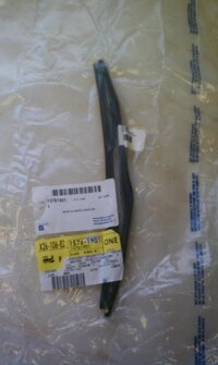

I know it may be difficult to find the right part #'s for some parts that only the XUV has. Here are some that may help you out in your parts search!
GMC ENVOY XUV Rear wiper blade assembly : GM# 15761901
I bought this item form the dealer (which never happens for obsolete XUV parts) on 1-24-12 for $12.68 (made in England). I had tried replacing the rubber blade only, but it never touched the glass all the way through the wipe (i can here the comments coming).

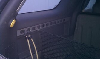

just ordered the roof rails from vpartsinc. did yours come as a pair?
also, can't find those cargo rails for the back. instead, i used eyebolts. if anyone needs them, i got'm at fastenal: sized m8, 1.25. the only ones they had are 13mm to the shoulder. if the plastic casing is set right, (mine wasn't), there's just enough thread to bite real good.
