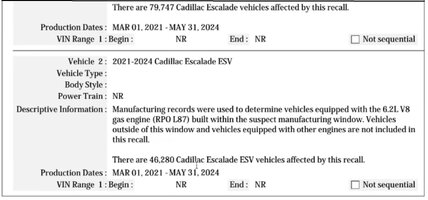

From "Rainman Ray" on the Hazards caused by Engine Failures in 2021 to 2024 GM, GMC and Cadillac Vehicles on a Safety Recall:
P0016 = Engine Replacement via the Recall TSB
GM Recalls Nearly 1M Vehicles (Catastrophic Engine Failure) Are YOU affected?

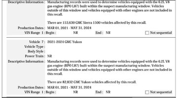

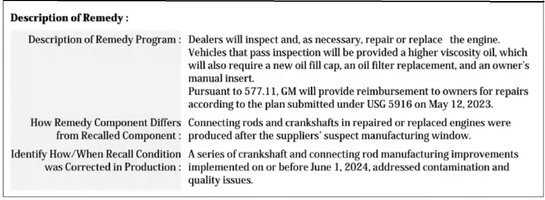

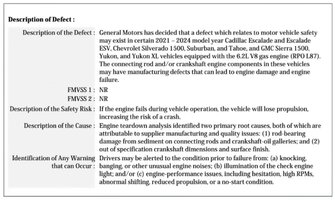

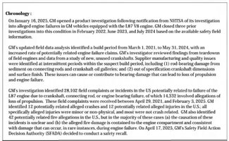

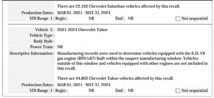

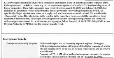

Important Search Info and Background from @Mooseman 's Video:

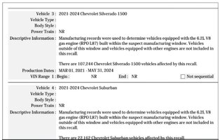

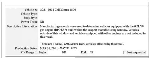

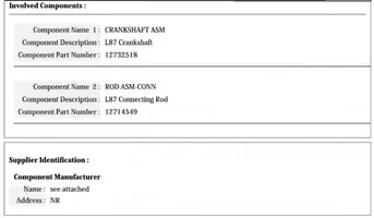

APROBLEMCHRONOLOGY1.jpgAPROBLEMCHRONOLOGY2.jpgDESCRIPTIONOFDEFECT.jpgDESCRIPTIONOFREMEDY.jpgINVOLVEDCOMPONENTS.jpgPARTSAFETYRECALL1.jpgPARTSAFETYRECALL2.jpgPARTSAFETYRECALL3.jpgPARTSAFETYRECALL4.jpgPARTSAFETYRECALL5.jpgPARTSAFETYRECALL6.jpg
And here's the Motor Oil Geek explaining why GM is now specifying 0w40 in these engines instead of the watery 0w20:
My LM2 3.0L Duramax also uses 0w20 and wish I could go to 0w40, especially in summer, but I'm still under the drivetrain warranty and it specifies a DexosD certified oil. But then there hasn't been any, AFAIK, lower end failures of these engines. Looking at the list of DexosD certified oils, there are three 5W30 certified oils. The MOBIL SUPER 3000 FORMULA DD 5W-30 seems to be sold only outside of North America so basically in warmer climates. And reading the descriptions for these oils, they are actually Dexos2 certified so they are really just regular oil that they are making oil makers pay for the certification even though it's already certified. Dexos2 and DexosD are basically the same.
One Important issue that to some degree depends upon Owner Behavior: Do NOT Clear any DTCs (Especially the P0016 Code) with your Scan Tool ...if you intend to visit the Dealership to have your Suspect Engine investigated for a Qualifying Engine Swap.

Here's a teardown of one of the actual recalled engines. Wow. No holes in the block or broken rods but the failure is just unreal. Somebody was asleep either at the drafting table or the build plant. Wow!

Moving to the higher weight oil is a patch, it does not address two fundamental, root cause problems.
Problem #1: The L87 appears to have substantially narrower margins of tolerance for oil viscosity and main/rod surface finish (i.e. as designed & produced it runs much closer to its intrinsic limits, thereby increasing risk of failure).
Problem #2: Crank supplier performance & capabilities notwithstanding, GM's supplier management & incoming QA/QC processes allowed marginal or out-of-spec material to be accepted for an extended period of time (not weeks or months, but years).
One more thing: blaming EPA CAFE mandates driving lower viscosity oils is a red herring. GM is responsible for developing & releasing what increasingly looks like a marginal design and then failing to properly ensure adequate process controls were in place & operating as required.
