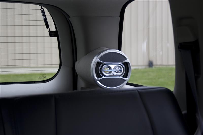

I know it's not really practical, but I'd like to do this sometime soon:
I'd like to "fill in" the sound better in my Envoy, but I'd also go with slightly smaller speakers. Maybe 4"-to-5¼". I don't want stupid-loud, but just something a bit better than stock. I've always been a fan of a rich, clear, surround type sound.
