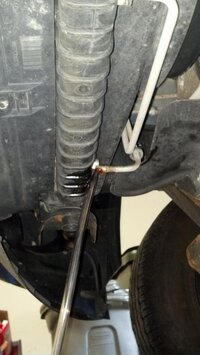

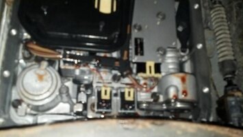

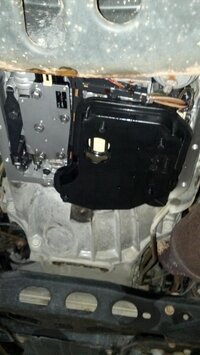

you remove the passenger side trans fluid line off of the radiator, connect a hose to it, put the other end in a bucket. start the engine and run it until you start seeing air come out of the line. then shut the engine off, drop the trans pan and swap your filter. reinstall pan and trans line to radiator, refill through dipstick tube.

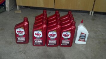

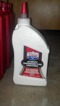

Well I flushed the trans yesterday,:wootwoot: It was pretty straight forward. my fluid was not as dirty as i thought it would be, it still had the reddish/pink color to it.
I can say, it seams to be shifting smoother.
I ended up flushing a bit too much, and my pan had a total of 15qts in it.:crazy: had to ride my bicycle to auto for more fluid :rotfl:
Since I bought my TB with around 79,000 on it, assuming the previous owner had it changed at 50,000... I am a little over with 115,000 now. I added some lucas that helps with slips and overall performance.
