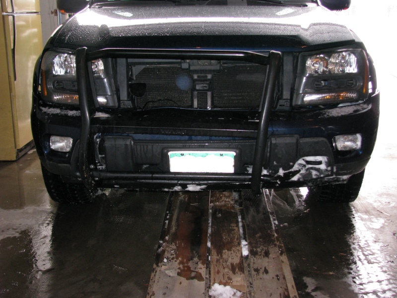

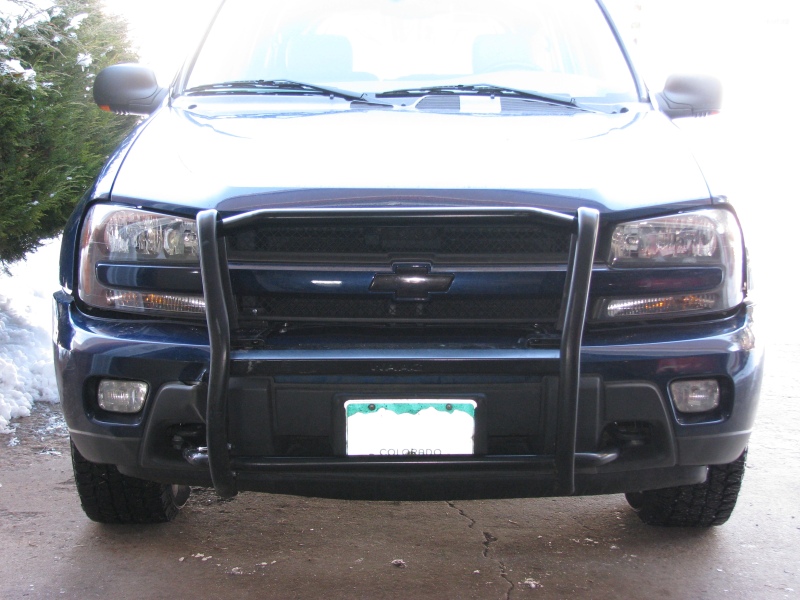

Figured I would get some pictures posted up. I spent some quality time with a big hammer this morning, working on the push bar. It's back in place again, and bolting things back together seems to have helps bring the underframe back into alignment again.
Before:
After judicious use of a come-along and some tapping from the side and underneath:
Still off by a couple inches, so I'm on the lookout for another sacrificial tree (kidding!)... Lots of waves in the pushbar frame, but it'll hold until I'm able to get something new. All in all, really not too bad considering everything.
