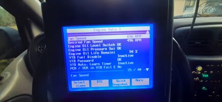

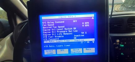

You're both wrong, sort of. The Tech 2 will show oil pressure however it's the FAKE fabricated pressure by the PCM.

MY Tech 2 on MY 2002 4.2 does not display "oil pressure".
I have tested a few oil pressure switches from the 4.2. They are a basic ON/OFF (open/closed) device. They are normally closed and they open at approximately 4 psi. This is all that any typical scantool can get from the PCM of a 4.2.
There is no variable voltage to or from this switch. It is a YES/NO device.
