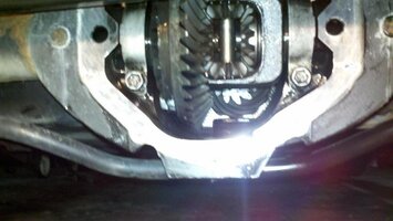

My old 02 had one but my newer 07 doe snot. The spot in the casting where it would be drilled and tapped is there. Is this some kind of cost reduction!

Yes. The cost of the plug and machining the the hole.
Removing the cover requires the spare to be removed. The bolts all have loctite so be careful. Be sure you can remove the fill plug before doing anything. I use PTFE tape on the fill plug to make removal easy next time. The cover gasket is reusable but just in case I bought a spare (#12479020 from gmpartsdirect.com $12.77) The entire job took 1:45. I do miss the plug on my old 02.....

Ok, I am lazy and not prone to create work (although thinking of some sonnax parts for my tranny) .. but I think I would drill and tap that cover- or weld a little thicker piece on if the cover is thin :undecided:.....just a thought. Looks like lots of room for the plug.
