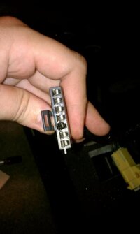

For some reason I thought I read somewhere that if it was the resistor pack that you will still have speed 5. Anyway, just went and picked up a new pack before the local auto store closed, but it did not come with a new pigtail. I asked them about one and they could not find it in their system. Anyone have a part number for it?

The connector can overheat and melt in such a variety of creative ways that ANY combination of speeds can fail and all it means is you have to replace the entire unit and often the pigtail, too. They also fail so often all good parts stores should keep the pigtails in stock. Dorman 645-702 is a popular one, but by all means not the only one. It's used in many other vehicles, so describing it to the parts counter person as the "damned stupid GM 7-pin blower resistor harness connector" should be more than sufficient to get him to cough you up a replacement.
