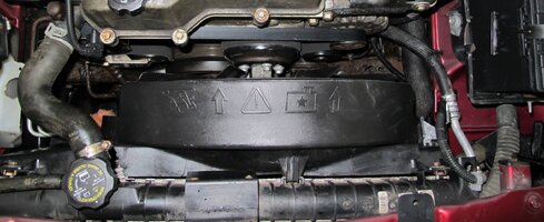

The clutch looks good. I've been reading a few threads, and there's a difference between an "electro-viscous" clutch and a "thermo" clutch?
The replacement ACDelco is listed for about $225 but the Hayden is $75. I'm guess that the expensive clutch is "Elec-Visc" and the other is a "Thermo."
Blckshdw
Nov 20, 2011
10,747
Tampa Bay Area, FL
I doubt they were damaged but I thought I read some posts that reffered to them as "torque to yield." Like you could only torque them down once.
The bolts that hold the head to the block are TTY, and can only be used once.
The EV clutches have an electrical plug, the thermal ones do not. I made the change from EV to thermal a few weeks ago. You have to have someone tune out the P0526 code for the fan clutch circuit, since you'll get a CEL due to no fan being plugged in, if you go that route. :twocents:

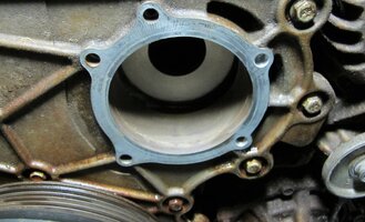

The tear down and cleanup ended, and now starting to install new parts. First part was that driver's side transmission line. Also, the pulleys were tidied up with a tooth brush and brake cleaner (carefully.) tb67waterpump.JPG
This surfaced cleaned up ok with Brake cleaner and paper towels. Then I decided to try 1500 grit sandpaper soaked with WD40. The idea came over me,,,It's probably not necessary, and it might cause a sealing issue (time will tell.)
