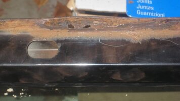

Rear Lift Gate
Left Passenger Door
The rest of the doors aren't as bad as the one. They have bubbly paint and small rust spots.
So what would be the best way for me to repair this??? I allready have a Rust stopper(Ospho) I'm thinking for inside the Door and lift gate, Wire Brush the Rust, hit it with Ospho and paint it.
FIRE AWAY!!!
Not overly bad. Time to fix it before it gets worse and creates real perforation.
Fixing the rust is easy, but the colour-matching afterwards is where the real expertise comes in.
If nothing else, you want to put some kind of fluid rust preventative into the panels and block more water from adding to this rust.

Your doors don't look terrible. How are your rear wheel wells?
I think it is a poor design on these doors and the liftgate. The liftgate plate insert seal goes bad and lets water into the innards of the liftgate, rusting the bottom of it out. The door skins were folded over but not smoothed or sealed well, so the water (especially salt water) gets caught in the seam and rusts the seam out, and spreads from there.
My liftgate is all brown and crusty across the whole bottom. By the time I try to get it fixed and replace the glass (defrost doesn't work) I might as well just replace the whole liftgate. It's almost cheaper. My rear wheel wells are crusty, particularly the driver side.

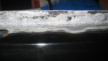

I turned this rusty mess (lower windshield frame on a Jeep TJ)....
....into this using lots of wire brushing and some rust killer....
....and then used some metal putty to re-form the shape in prep for painting....
IMHO, the MOST IMPORTANT part of this job was applying rust preventer to the inside of the windshield frame after the whole job was finished and painted. The inside panel is where the rust started and would have come right back again if it were not for the waxy rust preventer that was sprayed in there..!!
