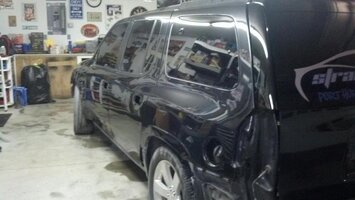

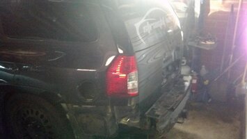

Putting airride on my 2003 Envoy Xl that has been wreaked and now paint and air ride. I have had it for 3 years its had a little bit of a rough life.
The day i bought it and the roof rack had to go

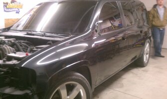

Put some tint on the front windows and pulled the running boards off
6000k hid kit
Demolded, clear corner headlights, tinted tails,tinted windshield,and steelies for winter

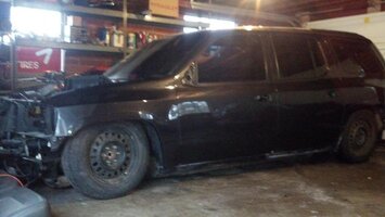

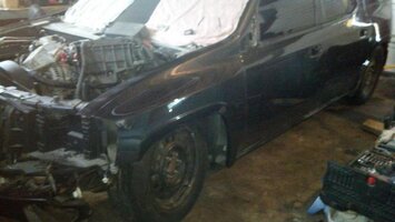

Then this happened she got totaled, bought her back with a clean title
Now new roof few other parts and paint

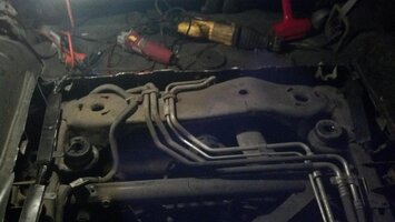

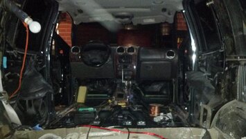

interior all gutted for second row bucket seat brackets
Cut back section open to start notch and bag brackets

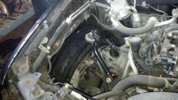

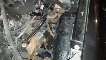

got my new djm upper arms one in for clearance for tire and wheel

That's a universal notch kit. He'll install and trim whatever isn't used. Only thing to watch using that is the panhard bar that is used by the factory will require one side of the notch to be longer(front to back), which that kit may not have enough to allow for. However if you switch to a Watt's link or some version of a triangulated link setup you will be fine. Keep us up to date on the progress!!!
Is there a Watts link that bolts onto our trucks and works as intended? Or is it pretty much custom made at this point? I'm getting to that point where I may be needing one eventually.
Its all custom make nobody sells a "kit" for our trucks. actually from my experience not many people at all sell "kits" for suvs mostly all kits are for pickup trucks.
