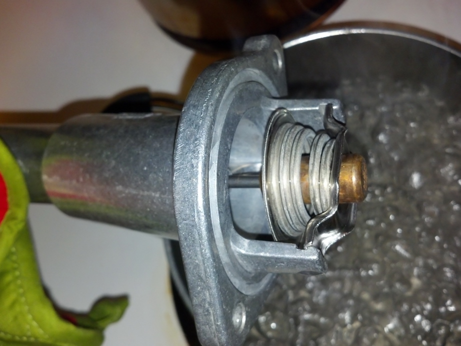

Jon A said:
However, I'm pointing out another problem with your new thermostat. This is what a properly functioning open thermostat looks like:
Compared with your new one:
11902d135974423t-bad-thermostat-radiator-heats-up-along-engine-img_20130123_153325_536.jpg
If your new thermostat does not look like that at 212 degrees, it is no good. Regardless if it is brand new or not. I flow rate of the coolant.
So I got my new Motorad thermostat and here it is fully opened. No where near as open as yours. What do you think is going on here?
I have noticed the bulb and valve are possibly scraping against the spring retainer and sidewall once again. Same as the AC Delco. Ive just had about enough of this. Please comment.
Jon A
Dec 25, 2012
5
Oops, I made a boo-boo, sorry. First I think that thermostat looks good. It’s open dramatically wider than the AC Delco so I think it’s working fine.
The reason it’s not open quite as far as mine is I had forgotten to mention the difference in temps. Mine’s a 180. Now that’s a whole different discussion/can of worms I don’t have time for at the moment but that’s the difference.
By 20 degrees above opening temp, a thermostat should be open 80-90% which it looks like yours is (.25”+ or so). If you heated it another 10 degrees in anti-freeze (not sure I’d do that indoors) it would probably open that last little bit. In general, they should open pretty quickly and linearly for the first 20 degrees and more slowly after that, opening the last 10-20% over another 10 degrees or so.
My stock thermostat that went bad would close properly (so I didn’t have the running cold problems you had) and crack open right at 195 as it was supposed to so there were no obvious signs anything was wrong with it. But after cracking open it would stop and not move at all over the next 15 degrees. That’s bad. That’s not how they’re supposed to work. When I saw the pic of your AC Delco I suspected that’s what it was doing as well.
It looks like the Motorad is opening farther and farther as you heat it up just like it’s supposed to; you just didn’t heat it up quite far enough to see it as wide open as mine. So I’d use that one without worry—it’ll work dramatically better than the AC Delco, that’s for sure.
CaptainXL
2,445
Ok the different temp makes sense. Was a bit worried there. I guess there really isn't a whole lot difference in valve height when comparing the AC Delco to the Motorad. At least none that I can see. So what I think I am going to do is go one step further and order a Stant thermostat. They are supposed to be the best.
A couple things about the Motorad that worried me aside from the pciture differences was that the inside appears to be narrowly obstructed. The entire housing is aluminum cast and they didn't do well with that. Second, there is no ball check for bleeding the air out like there was with the AC Delco. Third, there is no gasket on the valve itself like the AC Delco. If I had to grade this thermostat in relation to the AC Delco I would have to give higher marks to the AC Delco.
We will see what the Stant looks like.

Correction. The motorad open a bit more than the ac delco thermostat. I would have to believe the ac delco is a 210 degree stat. The motorad is a 192. The Stant will be a 190.
I just got one question. What is the correct stat temp?
WarGawd
Sep 2, 2012
468
Seems everyone has trouble finding data on the AC Delco 1511006 but I don't think it can be 210. The PCM controls the fan speed to fine tune the actual operating temp (I6 thermostat temp rating - Chevy TrailBlazer, TrailBlazer SS and GMC Envoy Forum.), which is several degrees higher than any of the standard 190/192/195 rated temps from the various OEM and aftermarket suppliers - any of these is probably functional. OTOH you may be interested in this review on Amazon that more or less echoes your exact experience with the Mexican made AC Delco
