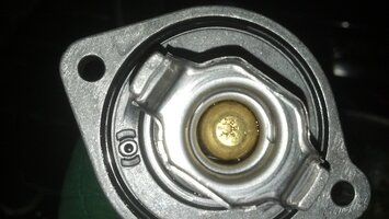

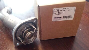

Tested the new one...
The thermostat doesn't start to open until about 198F of so. I blew into the outlet end of the housing while watching the water temp go up from 140F to 215F. I blew through it every 5 degrees so I could catch it in the act. Interestingly, I was hoping for it to start opening as low as 185F but that wasn't the case. Perhaps if there was some pressure behing the spring then it would open more easily. So to be fair lets say that it more than likely opens somewhere between 190 and 198F
I noticed that there appears to be a point when the thermostat is opening where the bulb rubs against the guide on the spring retainer (pictured below). Weather this is normal or not I don't know.
Now that I know it doesn't open or even start to open untill 198F I can go investigate the thermostat in my truck one more time to be sure.

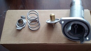

The thermostat unpacked:

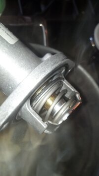

Thermostat fully opened at 212F. Man that's not that far. And notice the oring/seal ready to come out and fall inbetween the thermostat
Possible issue? Rubbing spring retainer. Note offcenter bulb.
You can definitely replace just the thermostat if they sell them. Just take it apart!

I recommend you do not install that thermostat. While it should solve your problems of running cool in the winter by closing completely, you're likely to have overheating problems in the summer. By 212 degrees it should be open three times that far. I believe the bulb rubbing on the housing is preventing it from opening as far as it should. Replacing these things is too much a PITA to do it twice.
I recommend instead you get a Motorad: Motorad 413-192 Thermostat : Amazon.com : Automotive . Quality. Made in Germany. It'll work. Test it next to this one and make your choice.
Jon A said:
I recommend you do not install that thermostat. By 212 degrees it should be open three times that far.
Well that's simple enough to test. I can just take the thermostat apart as in my last picture and see if the pintle actually extends further than before. I don't think it's really getting hung up on the spring retainer...just rubbing it.
Edit: Ok, I think I know whats going on here. The thermostat definitely opens alot more if the spring isn't holding it back. That is when the thermostat is removed and dropped into water by itself. It actually pops when the water goes boiling.
Now of course the spring pressure must be figured into the equation when it's all put back together with the housing. So naturally the spring must overcome the pressure of the water pump to retract the thermostat when the coolant gets cooler. So all in all this appears to be normal. Funny that I'm being overly cautious about all of this. Better to be safe than sorry I guess. Let me see if I can find another stat in a store around here and I can confirm my findings.

Two different problems. Yes, I do believe your current thermostat is sticking open which is what is causing the problems you are encountering now. Replacing it should fix that problem.
However, I'm pointing out another problem with your new thermostat. This is what a properly functioning open thermostat looks like:
Compared with your new one:
11902d1358974423t-bad-thermostat-radiator-heats-up-along-engine-img_20130123_153325_536.jpg
If your new thermostat does not look like that at 212 degrees, it is no good. Regardless if it is brand new or not. It will cause a completely different problem--it will limit the effectiveness of your cooling system. In the summer when it's hot, if you work the engine hard the cooling system won't be able to keep up with as much heat production as it should be able to due to the limited flow rate of the coolant.

Thats great info guys. Jon that demo you did is great. I am going to boil my new tstat one more time fully assembled. I could only get it to pop fully when removed from the housing. Jon what brand is that? Motorad?
Wargawd. Thats was a cool demo as well. Thanks for clarifying. Did you notice the upper radiator hose having any warm coolant escaping towards the radiator during that test? I dont have a thermocouple so cant replicate your findings exactly. So just to clarify you tested the temp of the coolant at the top and bottom of radiator?
Yes, a Motorad. They are available in some local parts stores but easy to find online as shown above. For reference, it opened .3"-.35" (not perfectly evenly) which is pretty typical for an automotive thermostat.
As I said, replacing them is a bitch. I wouldn't go through the hassle only to put a sub-par one in there.
Tested the made in mexico ACDelco again. Seems to not work well at all. Gonna order a Motorad 413-192. Amazon is also sending me a replacement ACDelco tstat. I just want to see if they really are bad. Perhaps I just got a dud.
