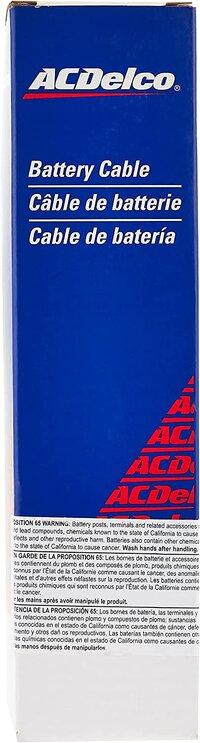

If it were me...I'd Skip "The Mickey Mouse" and the Palaver ...and just Do It Right...
ACDelco GM Original Equipment 4SX40-2FSA Positive Battery Cable
ACDelco GM Original Equipment 4SX33-1FSA Negative Battery Cable
