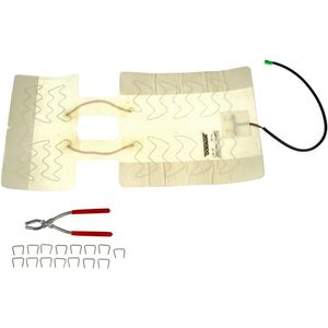

UPDATE: Finished Swapping Suspension to the new truck, Red is finally sitting where she belongs.
Side note, got an issue with the heated seat on the passenger side, the Driver seat back and bottom work but on the passenger seat only the BACK works not the seat bottom heater, where should I start the trouble shooting on that?
TollKeeper
Supporting Donor
Dec 3, 2011
8,371
Brighton, CO
More than likely just needs to have the heater replaced.
I buy the replacement butt heater thru AutoZone/Advance auto using the Dorman brand.
They come with a lifetime warranty, and it is likely to fail again.
Or you can punch in that part number, 641-107, into ebay/amazon, and see what comes up.
Mooseman
26,587
Ottawa, ON
Likely the heater wire on the seat foam. It usually breaks and burns out where is passes under a metal retaining rod. Very common issue but usually on the drivers side since it's used the most.
Edit: Looks like we posted at the same time. If you do replace the heater, don't pass it under that metal rod.
TollKeeper
Supporting Donor
Dec 3, 2011
8,371
Brighton, CO
Or do what I did, cut the rod where the seat crosses the heater pad.
