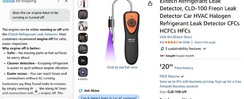

will try out the sniffer not sure if the engine should be running w/ AC turned on to use the leak detector?

I believe the false readings his sniffer where detecting was due to the sniffer tip being to close to the tubing I believe th e sniffers tip must be 1/4" off the tube not in direct contact w/ tube.

I would vacuum it, check to see if it holds vacuum and then fill it. You have so little in there now that the sniffer may not pick it up with so little pressure. Once refilled, I would then go with the sniffer.
