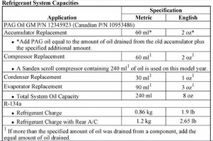

As per the attached list of system capacities, when you replace the accumulator, you must add the appropriate amount of oil that is trapped in the desiccant bag.
