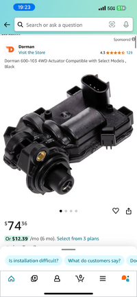

If i were to buy a new actuator, what one do you recommend, i was thinking this dorman one from amazon. Also if i were to plug it in and switch on 4H should it plunge right away?

I cannot personally say if one unit is better than another. I have never had to replace an actuator. And I get most everything I need from the U-Pull&Pay where such items are like $10.
I recognize that "AAM" logo... the same manufacturer made the original disconnect assembly as well.
Over $100 !!
I'll keep getting my stuff from the U-Pull, thank you.
