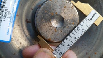

I'm at an "oh no" moment on this build.... The Engine I've *Lollipopped* with sweetness does NOT have the same flywheel assembly as Mr Richard "PRIOR". I've got this frickin' engine in front of the fresh 4L60E setup hanging in the air right now..... Does anyone know off the top of their heads what in the bleedin' bloody dickens this specific pressed in reducer ring is relative to? I've got 0 frame of reference for what transmission they were potentially running this block with, as I never did actually see the old vehicle, although I've got that VIN#.
I know I have to swap these wheels, but I haven't seen this specific adapter before, and there's not gonna be any matey-matey with this business currently *out of order* as it stands.
Does this ring anyone's memory bell?

In continued Elaboration, this is the GM P/N 12621694 Flex Plate ASSLY installed at this previous engine configuration (with whatever the heck this adapter was adapting to), and this reducer is pressed into the 41mm I.D. Of the Crankshaft -> Torque Converter snout relationship void which *IS* going to work with my GM P/N 17804017 Torque Converter replacement carbon copy update @ the existing 4L60E that's currently in place.
It looks like I'm going to have to tig weld a nut to the face of this adapter and screw jack this interference fit out with some persuasion TLC.
I Don't wanna do that.
I don't know what else wants to fit in a 13/16" I.D. void that's gonna pull this joker.
I've never seen this before, and I've never been in this situation before.

Thats the pilot bearing I think, or the automatic transmission variant of it... Lots of different removal tools on the market for it.
It is a needed part, as it centers the torque converter so all the pressure is not on the smaller outside bolts. So you will need to find the correct pilot bearing for your application.

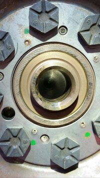

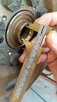

Thank You Sir!! Yes, at the moment this pilot bearing is "in the way" of the torque converter nosing in to fit, I do cherish and appreciate your prescription for the exacting of the pilot bearing puller. -Looking At Those Presently- I'm not certain what form factor transmission supports or requires this pilot bearing?? It's not this configuration of this 4L60E tagged "8SWD".

Can you take a picture of the whole flywheel?? Something not right, and hoping that can clear it up..

I think the piece you are looking for is called a toque converter thrust spacer, or maybe a pilot sleeve, or crankshaft adapter?

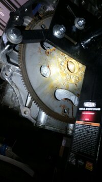

You got it. These flywheels are different. One is a flex-plate assembly, the other(original) is just pure flywheel ring gear.

"New To The Vehicle" - On Crane

I think if you measured the spacer from the 2 points marked, you will find it has the space needed. So you just need to get the pilot bearing puller, pull that section out, and I --think-- you should be good.
Good Doctor Good Sir, *THANK YOU* very much for your specific encouragement along this course, I do concur completely, and that is the course of action I'm currently in the midst of taking. I just got all my measurements and I might be driving half way across the state to go pick one up in the very near future, but appropriation is the target of this evening.

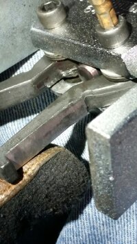

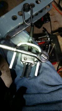

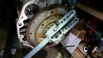

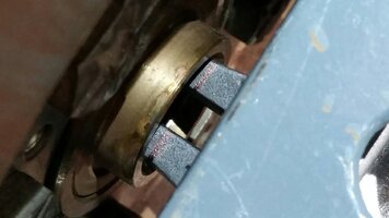

It was a tearful moment when this joker slid out into full expression. I did drive halfway across the state last night to pick up OTC & OEM pilot bearing slide hammer attachments because I knew their teeth were viable/formidable form factors.

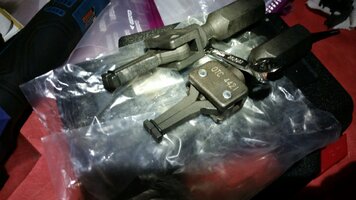

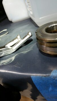

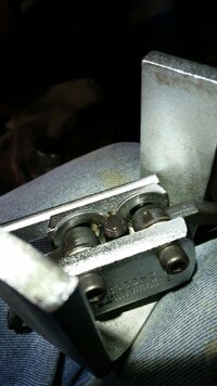

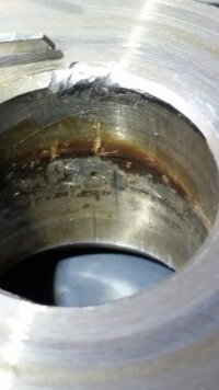

These were the considerations over the schmoopdee woo glass slipper loaner K-Yoke-Pilot Puller from Powerbuilt - not all bad brand stuff, but those powerbuilt puller legs were a no-bueno recipe for "that's not gonna work either" from the get-go when I took a gander at the local auto partication station. Took the morning to file those OEM leg jaws into "presentable" condition, as their castings were also a tad schlopptastical. - You can see where the Powerbuilt pullers "slipped" on that poor slug last evening around 10, where I found out by the GRACE OF THE GOD OF MECHANICAL APTITUDE that the contingent OEM/OTC's were *always* - The Only Way -.

Mooseman
25,355
Ottawa, ON
So the question remains, why was there a manual tranny pilot bushing when no manual tranny was ever available on this platform? A swap by the PO? Where did it come from?
  • Love
Reactions: 808
