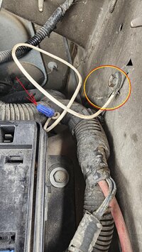

When "Time (and Moolah) " Permits... Consider investing in an inexpensive Automotive Wire Kit that includes pretty much all of the Standard Colors (From 10-12 Colors) and in the correct AWG (American Wire Gauge) gauges (and Lengths) for doing any and all Wire Repairs that may be revealed as your investigation proceeds. There are quite a few applications where having all of this gear handy around The Farm would not be a bad idea...either. :>)
Unlike the Common Electrical Wire for Indoor Electrical applications being temporarily used in your Ground Wire Substitution... Auto Gauge Wire is meant for use in the Harsh, High Temperature Environments "Under The Hoods" of Cars and Trucks (and Farm Equipment) and features Bonded Insulation, Resistant to Damage.
Also, insisting upon only ever using the "Solid Copper" flavors of AWG Wiring in all situations versus the less reliable and less durable "Copper Clad" Aluminum Wire that is a sad and sub-standard alternative is the REAL Wire Conductor Version you will want to choose and stick with:

As you become more familiar with using an inexpensive spool of REAL Lead-Rosin Core Solder and applying the Shrink Tubing Insulation over the wire lengths BEFORE you begin the work ...you will find that as it Seals and Melts around the Newly Bonded Soldered wires, it will give you lasting Peace of Mind and you'll not have to look over your shoulder too often wondering if any "Barrel Nuts" hiding Twisted Wires inside may work loose over time.... and come back to haunt you at the most inconvenient time.... ( Like the Blue One adjacent the Red Arrow in your original image).
And... Trimming away those Frayed Temp Ground Wire ends at the Fender Well Bolt will prevent surprise finger and hand injuries by getting snagged on things later on as well (those Loose Ends are all within those Red & Yellow Circles):
