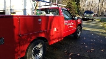

E2C5353E-065A-4207-A6A3-FC334E2A7AA9.jpegPolished and waxed, also cleaned the interior so it isnt so dirty. Also did the brakes yesterday. Notice the cab lights are working now :2thumbsup:.

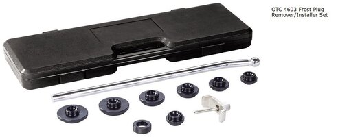

If you need a permanent solution to the leaking Frost/Freeze/Expansion Core Plug problem… Dorman Brass plugs are the way to go. Here is the link to the ones available individually for your Engine Block from RockAuto… and Melling also has a listing there for some that are slightly Over-Sized if the need arises that the stock steel or even the Brass ones will not plug the hole in the Engine Block and seal properly.
I like to coat insert edges of these plugs with the Permatex High-Tack Non-Hardening Gasket Sealer as this stuff will resist EVERYTHING that can make any seals and gaskets and plugs like these fail over time ...just prior to gently and uniformly pounding the Core Plugs back into Cast Iron Engine Blocks ...and the OTC Frost Plug Tool Kit is the one you want to get this job finalized the right way:

For the OTC Frost Core Plug Installer Tool Kit:
https://www.amazon.com/dp/B000XSGKYO/?tag=gmtnation-20

DB7B4ABF-B7EA-488F-8693-23B100D1BC58.jpegC67B490F-C47E-4064-BD80-D140BAC9F6DB.jpegHeres some pictures of her at work today. She doesn’t like oil, keeps leaking even after the timing cover replacement.
