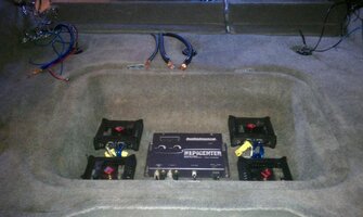

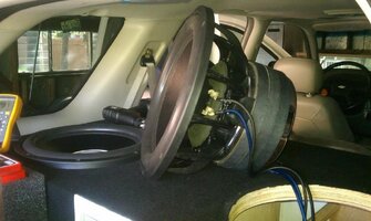

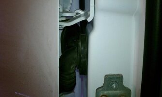

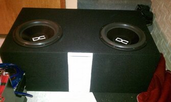

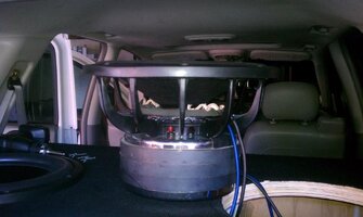

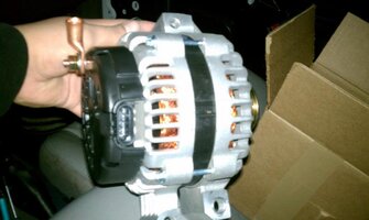

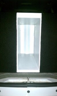

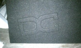

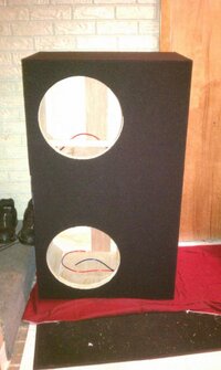

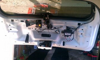

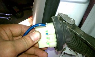

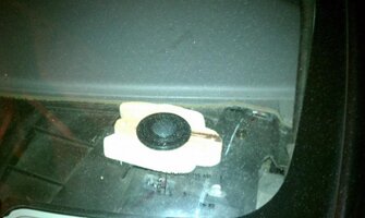

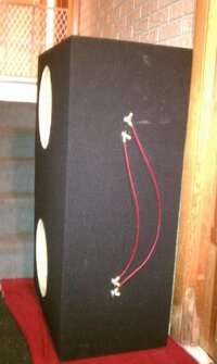

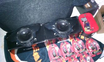

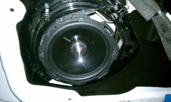

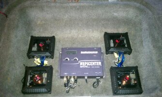

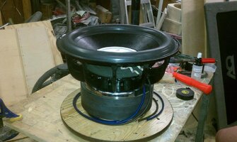

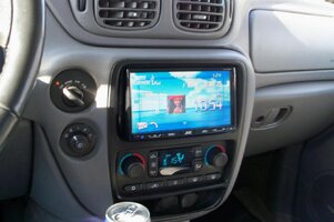

Posting up my build. Sorry if the pictures are not in order. Highest number Ive hit was a 151.7
2 DC Audio Lvl5 15's (Now With PSI recones)
Rockford Fosgate t2 components front and rear
2 Sundown Saz2500's strapped
1 Sundown Saz 100.4
Jvc Kwx-820
Audio Control epicenter

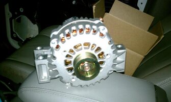

Mechman 270 alt
4 Enersys xe95 batts

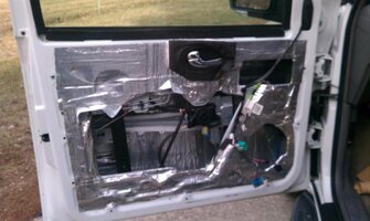

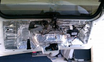

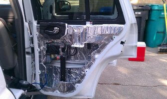

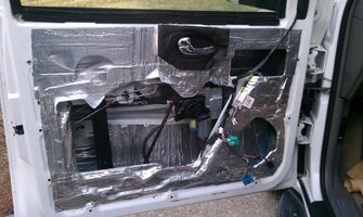

Lots of wire & Audio Technix deadener

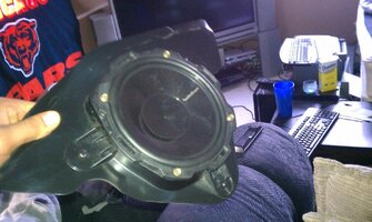

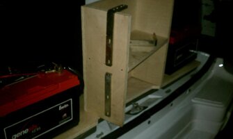

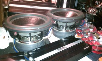

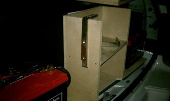

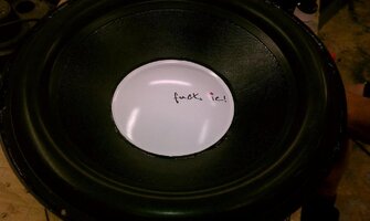

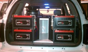

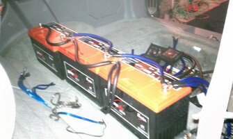

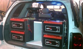

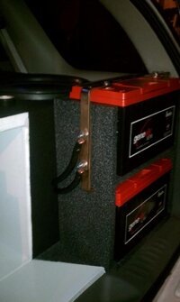

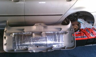

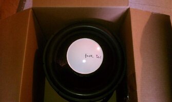

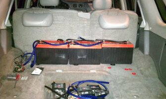

New Updates. Built New battery rack and added a 4th battery. Got new recones from psi. I ended up breaking the tinsel leads on the old recones. When I took them apart the coils were just fine. For some reason the tinsel leads on these were not very strong. Heard I wasn't the first with this problem. New recones came with triple leads:biggrin:

looks good. like the battery rack. So what is the tuning freq? what freq was your 151.7 @?
Very nice. Looks like your work is paying off with those numbers.
Thank you. Too bad my truck isnt happy with 150db's daily:no:

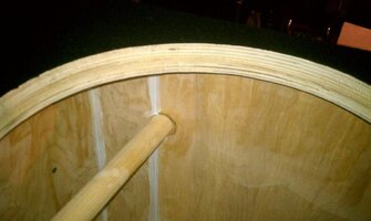

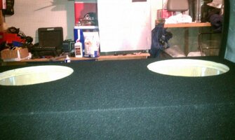

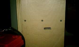

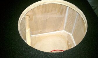

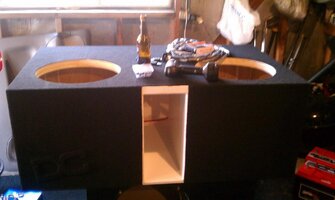

Im happy with it. Its a great setup for daily music. Doing the battery rack that way was the only choice I had with out getting rid of a back seat. I think it came out great. Looks really clean. Box is 7.4cuft@34hz with ~100sqin. Hit the 151.7 @39hz. Found out later that my truck peaks at 40hz
Thats a really nice setup. With that box and tuning it should be a great ground pounding daily driver. Level 5's are beasts.

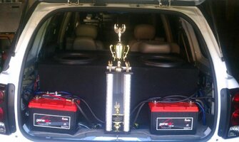

Ground pounder for sure. Not sure if you can see the ground pounder decal on the window.Yes these lvl5's are beasts they are huge and take take lots of power and sound good doing it.:biggrin:
