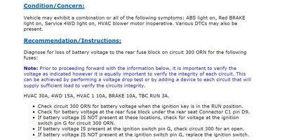

I found a document that describes some of the symptoms you are experiencing.

I took my Rainier and this printout to my mechanic this morning and he seemed confused. Hope he is able to find the problem!! Thank you!
