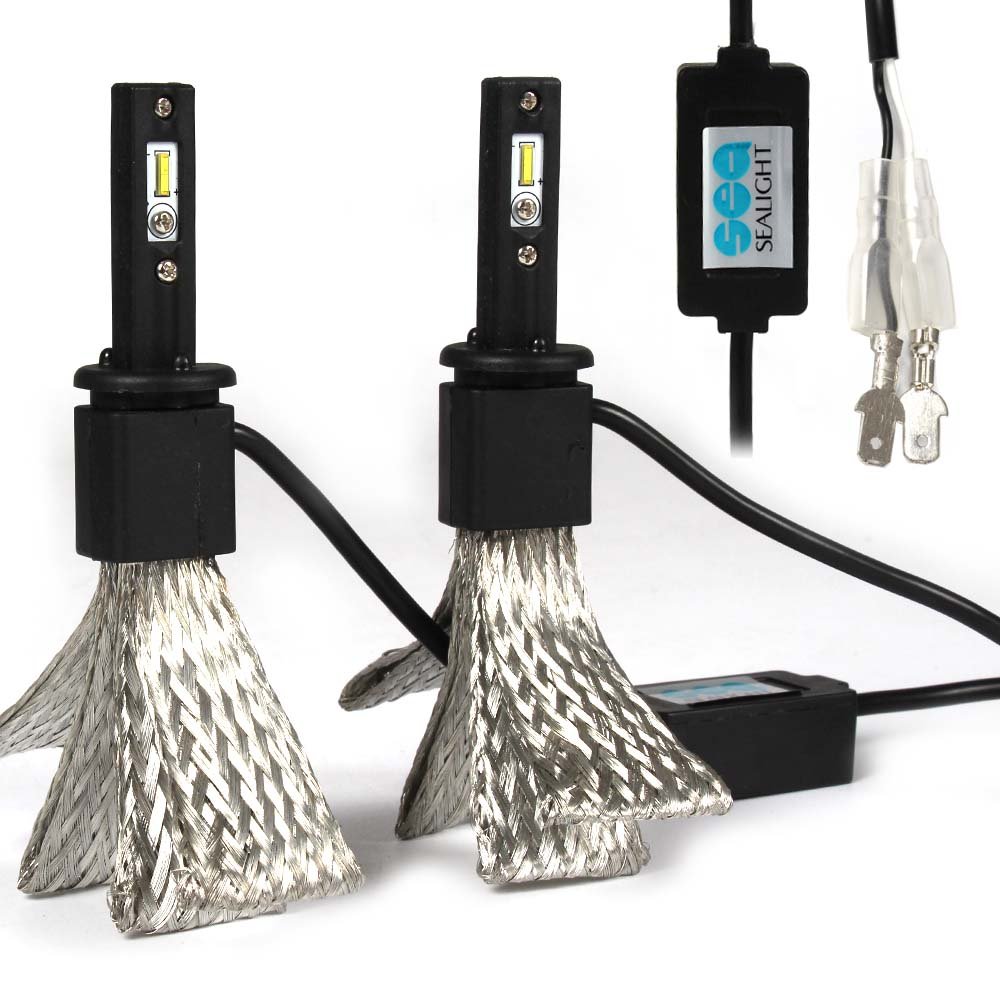

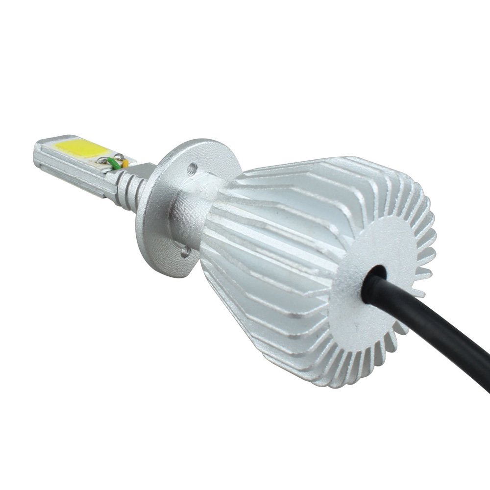

Bigger heatsink = better quality right? I'd get the bigger one but that's me.

Do you consider the braided as bigger? I am not sure size matters as much as actual cooling. A small 3 core radiator can out cool a huge single core.
Sparky
12,927
I think it would depend on how they're put in there. Mash the braids all together in a clump - not too good. Spread them out - mucho better.
The big solid heat sink with the wire straight out the back could require some space behind the light and I don't recall how much is back there.
But the all metal one may be more stable and cool better than the plastic clad one.

If I had it to do again, I would buy the ones with the braided heat sink, you could stuff that inside and put the covers back on.

I was told by a couple vendor at the 4x4 jamboree that the fans were not desirable for offroad rigs. The dirt and water n such would kill them. Surprising since they were actually advising us to use the cheaper ones then. Guess it is easier to sell people what works than deal with issues later on.
Sparky
12,927
I would agree with that, if you're running through water a bunch it could kill those fans. I honestly don't like little DC cooling fans on stuff out there as they typically aren't sealed all that well.
If the passive sinks do the job I'd rather stick with that. One less thing to go wrong.

The braided stuff is nice because you can stuff it however it fits.
Never heard of either of those brands. What kind of warranty do they have?
Saw these posted somewhere a while back at one point, more expensive but at least one I recognize.
https://www.superbrightleds.com/mor...-tinned-copper-braid/2216/5005/#/tab/Overview
I have a set like those braided ones and they have been in for a year now (stock headlight housing) and have given no issues whatsoever. The flexibility of the braid definitely helps with placement in the stock housing but im not sure if you would have the same clearance issues with the cooling fan style. I went with the braided ones also because no moving parts (passive cooling)
