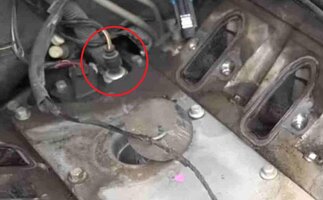

After symptomatic confirmation, if you are considering performing this Intake Manifold Gasket Repair and/or including the R&R of any Fuel Injectors yourself... Brian from Briansmobile1 Youtube Channel shows how this procedure gets done in his nearly one hour long video:
...and another from 1Road... WITH The Knock Sensor R&R, too:
...and while you are at it... Take advantage of the opportunity to R&R The Oil Pressure Sensor with an ACDelco OEM Unit AND the Small Engine Block Oil Gallery Filter (if present) while the access to that Sensor is so easy and readily available. If you have to do this later on... this Video will show you why it will be something to consider doing with the IM Off ...before it turns into THIS kind of a serious PITA Job:
Would you rather be able to R&R this OPS while having THIS much EZ access...?
...or have to Wrangle the Damned Thing In and Out under THESE Conditions?
