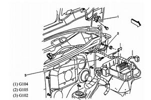

G102, G201, and G302 are the grounds you should be looking at. Let us know if you have a DVD player and or a navigation system, as there are a few more grounds to look for. When you find G102, there are 4-5 other grounds in that location. I would clean all of those while you are right there.
Make sure that after you clean each of those grounds that you put a dielectric spray/grease over the top and the bottom of each of the bolts.
Make sure that you remove the bolt and clean the bolt and where it connects to the vehicle. I've had a few that looked pristine but, were corroded underneath the bolt. I would also remove the antenna and clean the threads of the antenna and the threads that the antenna screws into.
Once you clean all of your grounds if you still have that annoying static sound... Start unplugging connections to your radio. I would start with the antenna and then there should be two other plugs that connect to the radio. One of them is going to be the power so, unplugging that will not help.
Once you find the power plug, unplug the other connection. If unplugging the antenna and the non-power plug and you still hear the static. I would assume the error in your radio system is the radio itself. I would start by buying a used radio from a junkyard and using the steps I provided above to verify that a new radio will resolve your issue.
