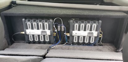

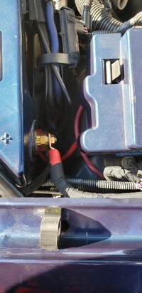

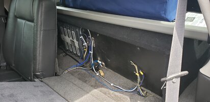

After almost 10 years of the same audio equipment, it was time to upgrade. At first, I was just going to clean everything up in the truck to keep me busy during the quarantine. I had surgery around the time my buddy installed my system all those years ago, so i couldnt help him, plus things have changed drastically from 10 years ago in the audio world. I wanted to clean up the wire harnesses and under the hood as well. Then came time for new amps, wires, and speakers. Some know my old setup from the meets back in the OG days. I was running AutoTek door components and 2 American Bass DX 12's in an aero ported box tuned to 38Hz with a class a/b 2 channel 800W Kenwood amp to each of the subs. Was good enough to hit a 143.7 at the local spl show so life was good. Plus i rip it all out anyway when I go to the track so i didnt want anything too crazy...

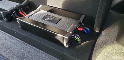

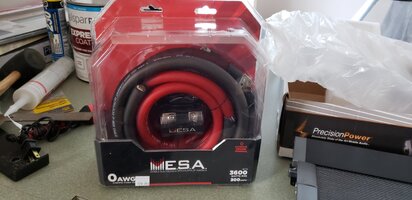

Fast forward to today, all my research. utilizing new technology, and installing equipment and she's all done and dialed in. MY GAWD is all i can say! It hurts sitting inside the truck now lol. I've never had my shirt move from the pressure\air inside the truck but now she's flexin pretty good haha. New set up is all Rockford speakers, Precision Power Black Ice amps running through a Pionner AVH4300 double din head unit. I've had Rockford components in the doors for a few years now and had the subs for about a year. Subs are 2 Rockford Fostgate P3 12's (600W RMS with dual 2 ohm voice coils) wired to 2 ohms at the amp. Monoblock Class D sub amp is the Precision Power Black Ice 7000.1D capable of 3500 Watts @ .5 ohms. I didn't want go that low. So I kept it at 2 ohms for 1500W RMS power. The 4 channel is a class A/B Precision Power Black Ice 1000.4 that is 100W RMS at 4 ohms per channel. Rockforrd components are only 80W RMS at 4 ohms. I made a new amp rack. Ripped out all the old RCA's, remote turn ons, and 4awg wire and upgraded to OFC 0AWG with running "speedwire" for the new 4 channel. Took me about a year to piece this all together and learn a few arears i was fuzzy in and i must say, i am EXTREMELY HAPPY with the outcome. Now it's time for some new spl numbers!
The old setup
Out with the old!
and so it begins
Time to clean this up...
Muuuuch better...

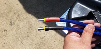

big difference! 0awg compared to 4awg

getting everything ready...
ok you get the idea... final pix lol...

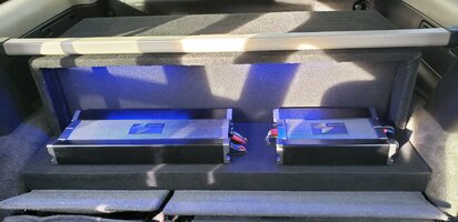

Little blue led action

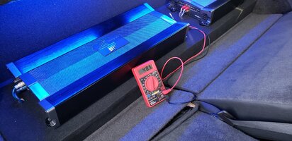

annnnd some final tuning using Ohms law since i dont have a SMD DD1 meter

Nice work on the new setup. I'd love to have a custom box, that would be a better fit for behind my seats. Give me a bit more usable cargo room to work with, without having to (re)move it when I've got larger items to put back there.
20200513_183001-jpg.94713
That pic reminds me I need to repaint the under hood plastic pieces on my truck too. Maybe when I get ready to start trying my HVLP stuff, those will be my learning pieces. :undecided:
20200523_190633-jpg.94719
Of course, you know I approve of this mod Well done! :laugh:

Nice build. :2thumbsup: sorry but I have to ask how the hell are you running that with out a cap or 2nd battery? On my brother-in-laws SS with the single 12" 3ohm anniversary jl w7 the lights dim and the battery runs down to 10.??volts with long low bass bursts.
Thx bud, My honest answer... I never thought about it 🤣. I didnt think a little setup like that would need something but with how hard it is hitting now... ehhhh it might be time to entertain the idea lol. On the old setup, sometimes my Voltage would dip to around 11.4. I had HID's then so the flicker was minimal since they have their own power supplies in the ballasts and I just switched to LED's last week so we will see how bad they dim. The only thing not new under my hood is the power steering pump, and the alt. When i did the cam swap, the shop mentioned to me that my alt was sounding pretty bad under the stethoscope and I listened myself. Shes grinding pretty good on those bearings lol. So I'll be getting a new one this year too, maybe even a higher output one, not sure yet. I havent played with this new setup enough yet to see how bad the Voltage drops are, but I'm sure I'm dipping into the 10's too...

Thx bro! I actually lost some cargo space because i had to push the box backward towards the liftgate to accommodate the new amp rack. Still enough room for my chair at shows and groceries, but that's about it lol.
Ive tossed around the idea of going back to stock engine pieces, or losing some of them all together (bettery cover, etc... ) but the jury is still out on that. The intake box and washer tank is gone since i have the FWI so all that is left that is painted is the engine cover, fuse block cover, and the battery cover. Time will tell...
But i had the led's laying around and was like "you know what, i need to light this b**** up!" :rotfl:
